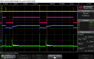

We are attempting to send high current (100-150A), 5V pulses to the load through a laser driver. We’re controlling the current, width and frequency of the pulses. From my testing, the power module seems to become unstable around 100A, 100us, 1kHz (see oscilloscope shots below).
FSEL=2200Khz             MSEL=HCL:2pF:2ms
  1. Trigger signal (controls the frequency/pulse width)
  2. Current monitor at the laser driver (scale: 40A/V)
  3. Vout of the TPSM843B22 Power Module
  4. Current Probe on the input of the load (scale: 1mV/A)
The power module appears to be going in to over current protection mode after running at these settings for a couple minutes. Is the behavior seen below expected in over current mode? Vout is pulled down to ~1V and becomes unstable, the frequency must be decreased to about 400Hz before operation is restored.

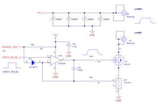

Here is a simplified schematic of the laser driver’s current source for reference. Most of the current to the laser comes from the capacitor bank, the power module supplies supplemental current during the pulse and charges the capacitors between pulses.

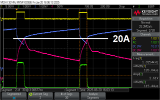

During the operating conditions described above, the current through the Power module spikes to 20A every time a pulse occurs.

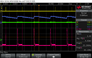

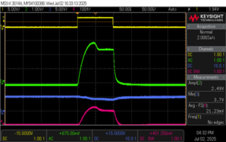

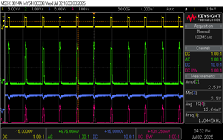

In the scope shot below, input power (red) comes from the 5V rail of an ATX power supply (No Power Module), otherwise the operating parameters are the same. This is to demonstrate the current waveform through the power module.
  3. Voltage across the capacitors
  4. Current Probe on the input Power

  • After reviewing your description, I can see that your application is quite different
    from the typical use case for the TPSM843B22.
    The most frequent applications are steady-state operation or transients loads
    less than or near the output current rating.
    To properly diagnose the issues you're experiencing, it would be helpful to have
    more detailed waveforms of the TPSM843B22's operation, particularly:
    VIN and VOUT voltage waveforms during pulse and steady events
    SW node voltage with shorter time division without the persist on.
    There are a number of protections on the device ocp, overtemperature, undervoltage protection.
    There is a high and low side current limit.
    16 cycles of high side oc results in a hiccup.
    LS oc results in hs side fet skipping a pulse.
    The OT (165C with 12C hystersis) and UVP (delay of 7xss cycles) results in a hiccup and restart.
    Power dissipation could be high on a 15V to 5V at 2.2MHz with high average output current.
    Also, the 4x3300uF could be influencing the control loop. The esr of the 3300uF form a zero in
    the loop which could push loop bandwidth out where the phase margin is low.
    The falling edge sw node jitter can be observed in steady state
    and with less extreme load step to assess stability.

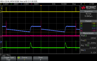

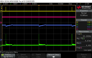

    Here is a shot of the input (CH2) and output (Ch3). we are triggering our laser driver at 22 Hz.
    Ch4 is the Module's 5V supply current into our driver.  the current probe is 10mV/A

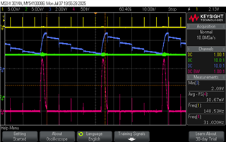

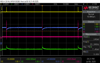

    This is the same, if the trigger frequency is 150Hz:
    The following two images are if we select a 7V output from the module. As you can see, it does not ever reach 7V. this is without any trigger pulses to our driver.

    If I reading the oscope plot correctly, the ATX supply voltage drooping to ~2.5V.  Drooping this much on TPSM843B22 will trigger uvp.

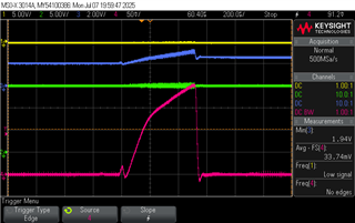

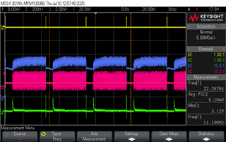

    Regarding our tests with the TPSM843B22, we took some comparison shots between it and the ATX supply.
    the supply voltage and current waveforms look very different. we would like to understand why.
    ATX supply:                                                                                                 TPSM843B22
  • The LM25145 and LM5145 are comparable devices, but with different voltage ratings.
    The ATX supply does not have protections.
    Without SW node waveform for confirmation, I suspect the TPSM843B22 has UVP triggered. Load step drops the output voltage
    below the uvp and the device shuts off for 7xsoft start times before attempting restart.
  • thanks. I'll get plots with the SW and PG nodes.
    7xsoft start times = 28mS in our case. that would explain the long ramp.
    I read that the undervoltage kicks in if the output drops below 80% of VREF. I also read that Vref is 0.5V. is that true? because in my plot, the output does not drop to 0.5V before the 30mS descending ramp occurs.

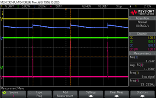

  • David,
    here are the plots with SW and PGOOD.
    if I reduce the laser current, I can get the voltage to be steady:
    I noticed that if the supply current does not peak to 20A, the converter can sustain the voltage
  • This is uvp
    Yes, uvp triggers at 80% of VREF on the FB pin.
    FB pin voltage of 0.5V is 5V output voltage
    and PG goes high when output is ~90% of 5V.
