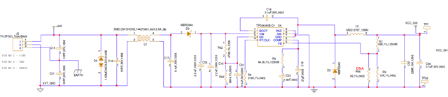

I am using TPS54340B-Q1 in my design. we are converting 24v to 3.8v using this IC. during radiation emission test we observed that we are getting more radiation from this IC. can you please support me how to reduce radiated emission from TPS54340B-Q1. Also please share how much this IC radiate. For reference circuit screen shot is added here.

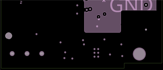

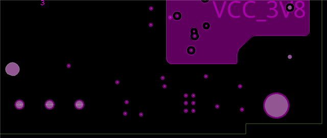

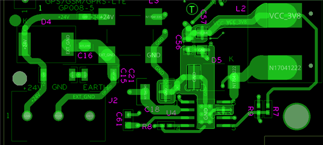

    1. Board is 4 layer board
    Top Layer
    Bottom Layer
    GND Layer
    VCC Layer

  • Hi Meghna,
    I reviewed both your schematic and layout and this is what I found:
    Schematic:
    • The component selections overall look ok. Please ensure that your inductor is rated at least as high as the high side switch current limit of the device to avoid hard saturation (5.5A).
    • A lower profile inductor will aid in radiated electromagnetic interference (EMI) performance
    • A damping capacitor on VIN can help with ensuring that the inductive ring from your input filter does not cause an out of spec operation on input.
    • A snubber on SW can be added to help curb radiated EMI. Please see this technical note for help in designing the snubber circuit appropriately: https://www.ti.com/document-viewer/lit/html/SSZTBC7
    Layout:
    • Overall, it is recommended that each layer have a ground pour that covers all available space. Ground helps sink some high frequency noise and can shield some more sensitive traces/signals from the high di/dt loops that characterize buck converters.
    • The input capacitors need to be placed as close as possible to the VIN pin. The VIN capacitors are a major portion of the high di/dt loop from VIN to the FETs that will create noise. Any increase in inductance on this path will result in worse EMI performance.
    • It is also recommended that the boot capacitor be placed as close as possible to the boot pin.
    • It looks like there is a via on the SW node. Please note it is not recommended for the SW node to have any through hole connections as this will effectively spread the SW noise into the entire system. Keeping the SW node as small and isolated as possible is critical to ensuring good EMI performance.
    • Overall, please check section 10.2 of the datasheet for an example of a good layout with this IC.
    Thank you,
    Joshua Austria
