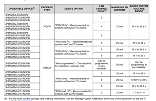

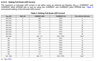

My customer is using LP8556 in quite margin state, they need Vout MAX = 21V, VIN 3.3V-4.5V, Iout per channel = 29mA, 6 channel.
Based on the D/S, sometimes it mentioned:
MAX iout is 50mA, but in the table:
May I know if LP8556 is suitable for this application?
If not do we have other suggestions?
