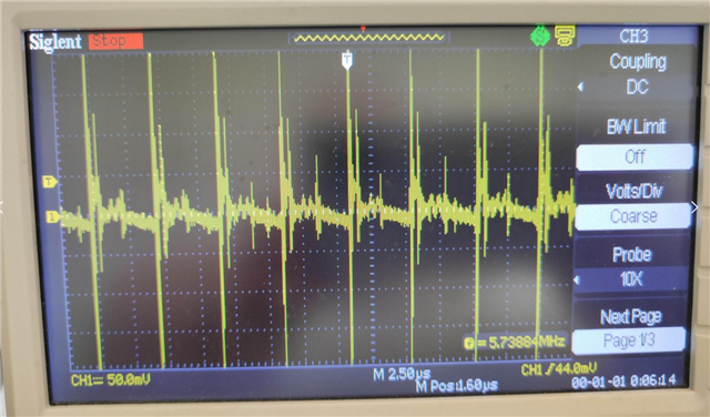

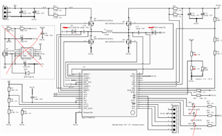

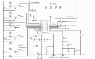

I have 5 cells in series using bq7791500 BMS I have tested separately that part with 2 A charging current and it works fine.
After connecting the charger i cant get more than 0.9A of charging current.
Input voltage 24V
Battery pack discharged to 18V
    Kichg is 50 A * kOhm. On the ICHG pin, there is a 47 kOhm resistor. The charge current is limited to Kichg / ICHG -> 50 / 47 = 1.064. Does the circuit behavior improve when this resistance is decreased?
    Michael
  • I've decreased it to 18kohm but there is no difference
  • Can you send a register reading of our I2C registers?
    Michael
  • I cant read the registers all I get is FFFF on all registers.
    I have pulled CE low and i am using mcu to read the registers.

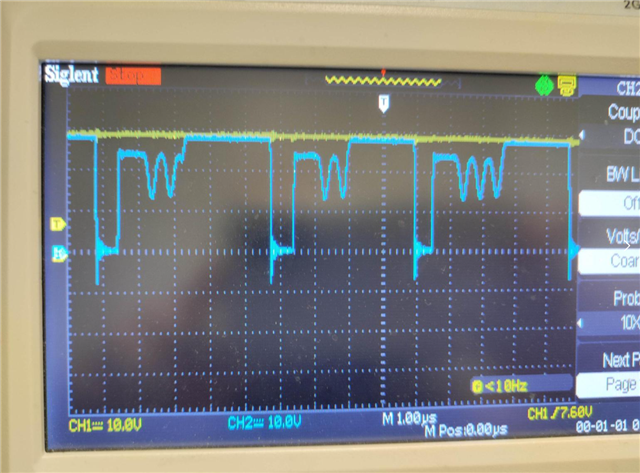

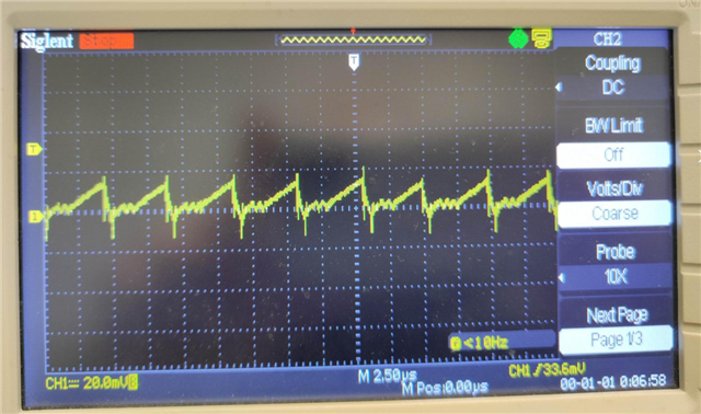

    These register readings are in decimal values, correct? The register 21 here looks like the device is not actively charging, and the register 22 here looks like the device is not power good. Are the SW1 and SW2 nodes operational?
    Michael
  • Register 20 is charge status 1     1000000000001011
    Register 21 is charge status 2      10000000
    Register 22 is charge status 3       0
    Power good, fast charging no problems but still the current is 0.7A
    SW1 and S2 are operational.

    • SW1
    • SW2
    • Output Voltage
    • Output Current
    Michael
  • SW1 - Yellow
    SW2 - Blue
    Output voltage - green
    output current ( measured with long GND leads )
    Input current, input voltage.  I replaced the switching transistors with lower input capacitance because there was high temperature rising on the IC drivers.
  • Hi Ilia,
    I notice that the SW1 voltage drops a bit during the high portion of the cycle. Does the input voltage here drop at all? If not, can you show the HIDRV waveform?
    Thanks for the current waveform. I am assuming that there is no dedicated current probe available. Would it be possible to try to shorten the large ground lead and clean up some of the noise?
  • Also, can you give me the part number/datasheet for the inductor selection?
  • measured with spring probe
    Q3 and Q4 gate drives
    Input voltage is stable all the time
  • Hi Ilia,
    The output current does not look proper. I notice on the SRP-SRN sense resistor, there is no filter network. Does the behavior improve by adding 470 nF across the SRP-SRN pins and 100 nF from each pin to GND?
    It may also help to balance the output capacitance across the sense resistors.
    Both resistors are connected in parallel as shown on the schematic, correct?
