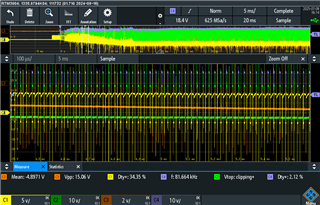

I am designing negative power supply with rating 10 V / 10A from 30 - 40 V, but I am facing strange behavior of LM5116.
We are using it as a symetrical power supply and with positive output we dont have any problem.
Durring loading Vcc voltage rises to 12V with generating audible noise. After few second driver is defective with LO side driver impedance to PGND less than 10 Ohm.

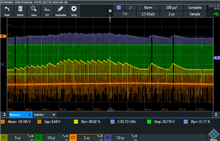

Situation is visible from my measurement
CH1       pin 15 IC2 (LO)
CH2       pin 20 IC2 (SW)
CH3       Negative Vout
CH4       pin 19 IC2 (HO)
detail at 2 A load. There is ringing, but I dont knot how to improve it.

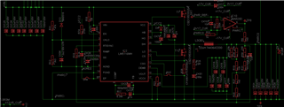

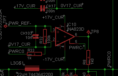

Part of schematic below (output voltage regulation is not implemented at the moment).

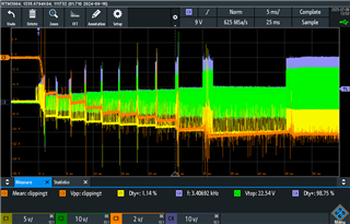

During power on procedure it behave strangely as well. It also generate strange audible noise. It is powered from power transformer with ideal diode bridge (that why there are steps during power on).
Thank you in advance for any suggestion what to test or change.

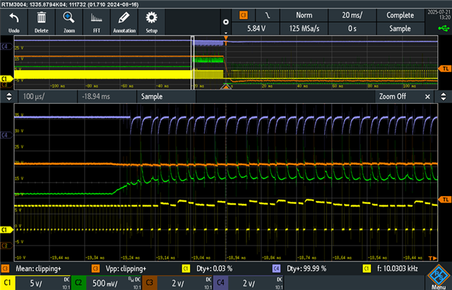

    Power on prodecure with CC 2 A load - High voltage on LO and HI pin is visible.
    Power on procedure with 7 A CC load

    Schematic is correct, i can send you complete design including layout in Eagle to PM.

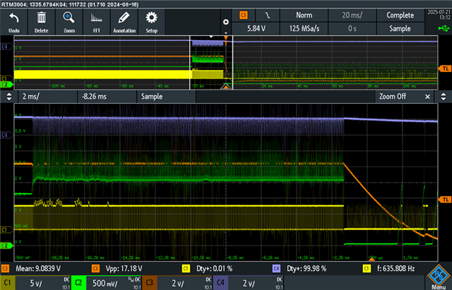

  • I found out that it was probably caused by UVLO divider that was originally 22k and 1k with 1nF capacitor on UVLO pin.
    In this situation with load more than 5 A driver was permanently damaged after few seconds.
    After approx. 4 dips on UVLO pin voltage on Lo pin increased.

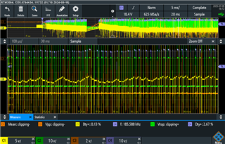

     During my measurement i change reference of my scope to negative voltage output (it is possible due to floating design on toroid transformer).
    Original situation on 4 A (electronic load in CC mode - in application note from TI I found out that it is not best solution for power on testing )
    CH1 is Lo side output
    CH2 voltage on shunt
    CH3 is ground of negative output (referenced to negative output)
    CH4 voltage on UVLO pin

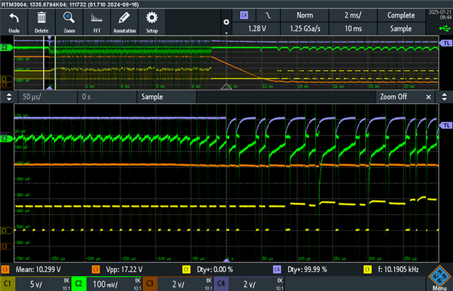

    In next step I try to change UVLO divider to 100k and 4k7. After this change driver changed it behavior and wasn't able to power on with electronic load on 4A (only with 0.5 A) but it is probably due to CC mode. Now I trying it in CR mode during power on stage.
    In this situation driver is capable to withstand 10 A load without destruction (it is in overload condition but it recovers).
    Situation with 10A CC load, it is visible that driver output on Lo pin is still increased with dips at UVLO pin.

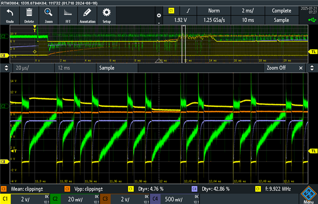

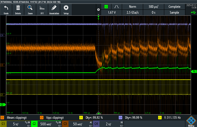

    I changed Cramp to 2.2nF and increased frequency to 102 kHz (33k)
    Situation with load step from 0A to 10 A,
    CH2 COMP output
    Now it is probably badly chosen compensation components?
    It looks ok with 4R load
    but 3R load is not ok and it is not stable, sometimes it goes to OCP?

    What this circuit is for ? You said it is Negative10V power supply, but looks like you are adjusting VOUT.
    -EL
  • Yes it is for adjusting output voltage, but it is not connected to the circuit at the moment. R31 is not populated.
