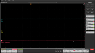

Hi TI expert,
Currently i'm working on the TPS25751's debug accessory mode entry, i tried to place 2x  Rd(5.1K) separately on CC1 &  CC2 line, both CC1 & CC2 voltage become 0.4V, i assume TPS25751 already observe the 2x Rd presence, but it failed to response since GPIO11 kept staying low(GPIO11 already configured as GPIO event #50: Debug_Accessory_Mode_Event). Could you kindly give some guidance on the Debug accessory mode entry, many thanks!
Attach the TPS25751 configuration setting as below:
0323-json.zip
Attach the waveform captured as below:
