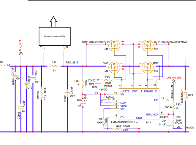

LM7480-Q1: one of the OV protection resistor is failing
Part Number: LM7480-Q1
Other Parts Discussed in Thread: LM5146, LM7480
Hi All,
Thank you for all the help and support.
