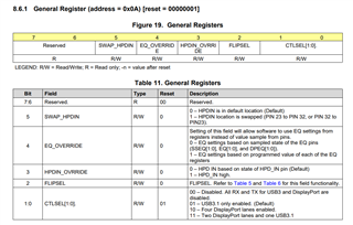

    The following register relate to alt. mode:

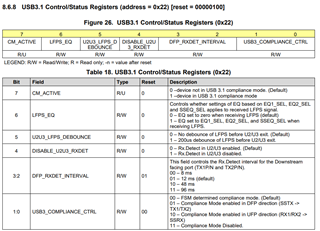

    These registers have to do with USB:
    What is the issue customer is seeing?
  • Hi Alan,
    Based off of the table provided in email:
    USB only (normal orientation):
    0x0A = 0001 0001
    0x10, 0x11, 0x12, 0x13 = Doesn't matter
    0x20, 0x21: Tune based on system
    0x22: leave as default
    USB only (flip orientation):
    0x0A = 0001 0101
    4-lane DP only (normal orientation):
    0x0A = 0001 0010
    0x10, 0x11 = tune based on system
    0x12 = read and chnage via AUX traffic
    0x13: leave as default
    0x20, 0x21: do not care
    4-lane DP only (flip orientation):
    0x0A = 0001 0110
    2lane DP + USB (normal orientation):
    0x0A = 0001 0011
    0x20, 0x21: tune based on system
    2lane DP + USB (flip orientation):
    0x0A = 0001 0111

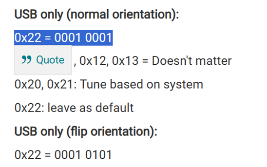

  • Hi Vishesh,
    Thanks for your reply!

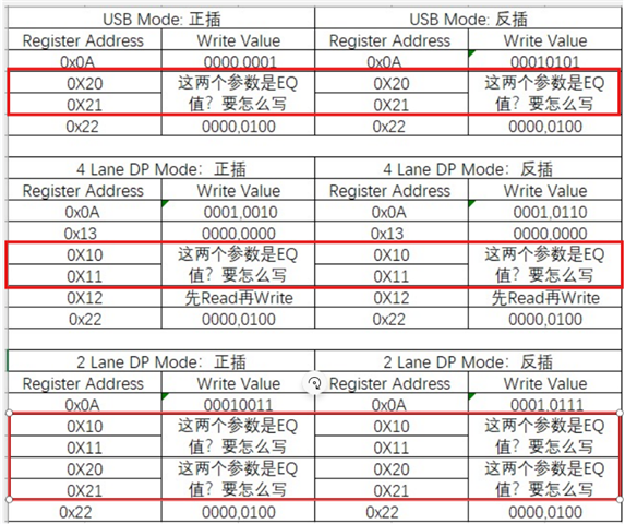

    Does the first one 0x22 is typo, means 0x0A?

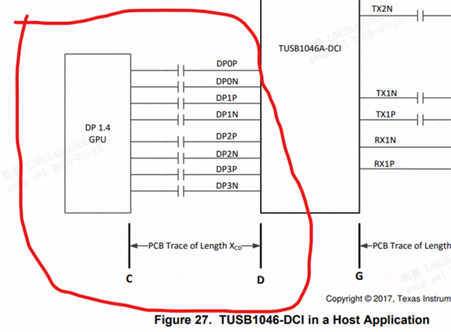

    Besides, Customer is asking how to config the EQ value in red circle, is that based on layout?
    Yes this was a typo, I edited the original message. Good catch!
    Yes, the EQ values will be determined based off of layout. You can approximate the loss of the pre-channel and post-channel by using the constant
    0.2dB of loss/ inch/GHz.
    for example a 10Gbps (5GHz) signal will have a loss of approx. 1dB/inch. You can use this approximation to create a range of EQ values that may work. Afterwards, testing eye diagrams will determine the best EQ values to use.

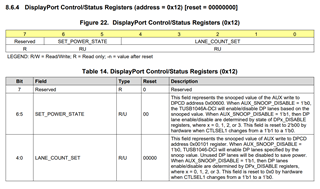

    The EQ value of DP is calculated using the distance from the GPU to the Mux Redriver, right?Is it this section of XCD in the image below?

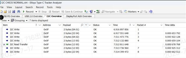

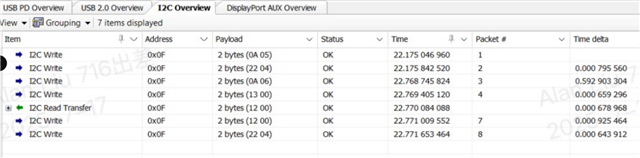

    And can you help to check below I2C setting in 4LANE DP mode? Appreciated for your support!
    Yes the DPEQ values are used to compensate for the loss highlighted here.
    Yes this is in 4 lane DP mode for normal and flip because 0x0A is either 0x02 or 0x06
    I recommend using 0x12 and 0x16 because this will allow I2C tuning for the EQ values. Otherwise only the sampled EQ values on the pins will be used.
