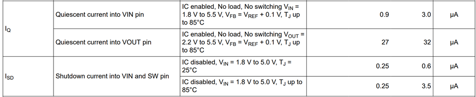

I am having a problem with high shutdown and quiescent currents. They are much higher than stated in the datasheet.

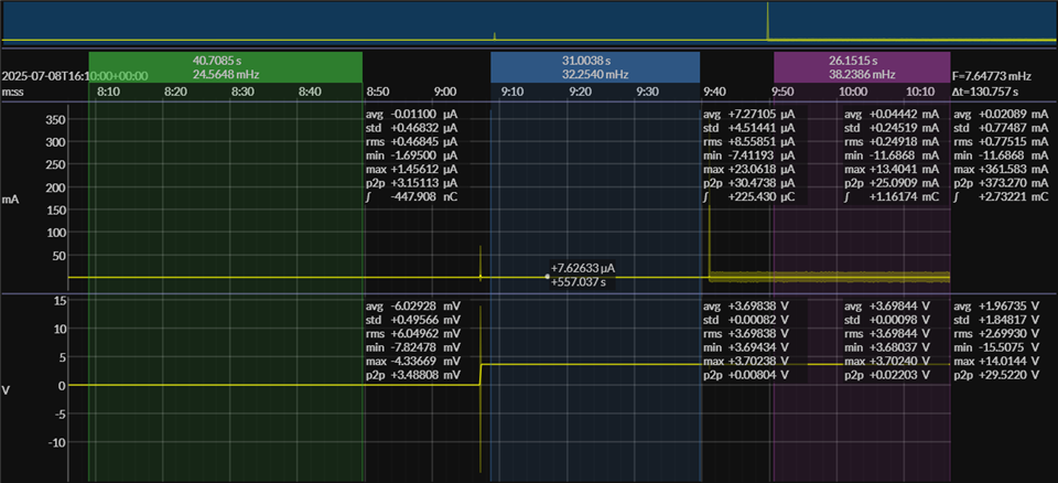

You can see from the pictures below the input voltage and current with no load attached.
Shutdown current is 7.27 uA and it should be ~0.25 uA and
quiescent current is 44.4 uA and it should be ~0.9 uA

  • Hi Martin,
    For the shutdown current measurement, could you try again with the C1 removed?
    For the Iq measurement, do you force 700mV at the FB pin?
    Lei

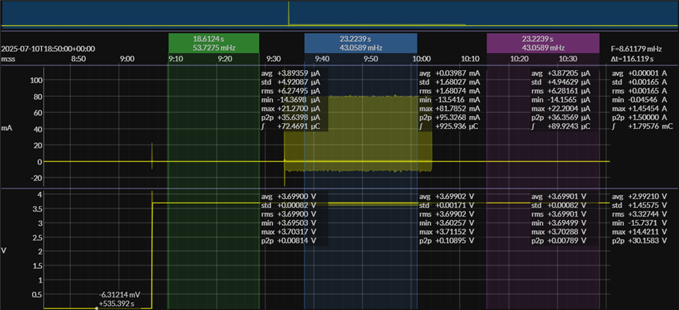

  • Hi Lei,
    Removing that 150 uF capacitor helped a lot. But I am still seeing higher current consumption when controller is turned off. Now it is around 4 uA.
    In the figure below you can see input current and voltage measurements. First and third cursor ranges are with EN tied to GND and the middle one is with EN tied to Vin. No load was connected to the output, and MODE pin was tied to GND.
    I have also measured the Input, output and FB pin voltages. Please look at the results below.
    CH1 is input, CH2 is output and CH3 is FB pin.
  • Hi Martin,
    I just verified the shutdown current on one new EVM, only with the 150μF capacitor removed and no other changes.
    Then test when Vin = 5V, EN = GND, MODE = GND, no load. The measured shutdown current is around 0.25μA, matched with the datasheet spec well.
    If available, please check whether the accuracy of the current meter or tool used in your measurement is enough.
    Lei
  • Hi Lei,
    You are right. I forgot to remove oscilloscope probes, and they were the cause for the higher current.
    Now my device uses around 0.2 uA in shutdown mode and 30 uA in active mode.
    Thank you for your assistance and help.
