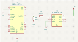

Ok, we have the BQ51050B in our design, however we coudn't get the TS/CTRL function to work properly.
Our goal is to control the TS pin from an external I/O pin, as we do already have a precision temperature sensor right next to the battery in our design.
So we connected the TS/CTRL pin to a 10k resistor to ground and have a connection from the TS/CTRL to our host output pin. However, the pin has a 100k internal pull up, that can't be disabled. Therefore, we added an additional external 100k resistor in the trace between the TS/CTRL pin and our output. With it, I achieve a voltage of 0.165V at the TS/CTRL pin, which is above the LOW treshold of 0.1V and below the high trheshold of 0.2V.
However, the power transmission doesn't start at all. If we cut the trace to our host, power transmission works as expected. I assume the resistor measurement is offset by our voltage, but how can we solve our problem?
