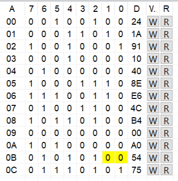

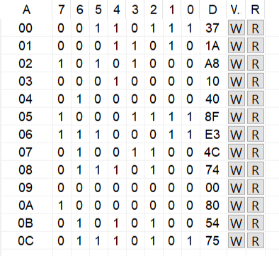

    Please share a schematic as requested. Please report I2C registers when the issue is happening. Previously provided registers do not paint the whole picture as the adapter is removed.
    Mike Emanuel
  • Hello  ,
                          We are not using custom board, we are using EVM only.
    Please report the I2C registers in total when the issue is happening. Previously provided registers do not paint the whole picture as the adapter is removed.
    Mike Emanuel
  • Hello
                        Please refer below images
                        Charger Disconnected:
                       Charger Connected:

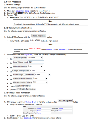

    We are missing something here. Can you follow the EVM test procedure and see if that works as expected as a starting point?

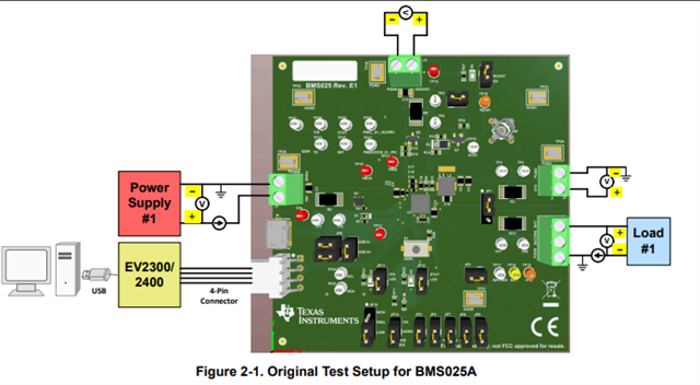

  • Hello
                   We had followed EVM test procedure as per below
    And this is the setup
    Test Results of Initial Settings
    1. Battery Disconnected, Only Electronics Load Connected
    • VBUS = 5.07 V
    • IBUS = 470 mA
    • VSYS = 4.145 V
    • ISYS = 520 mA (CC)
    1. Battery Connected, Electronics Load Disconnected
    Note: Without charging, VBAT = 3.4 V
    • VBAT = 3.5 V
    • IBAT = 445 mA
    • VSYS = 3.8 V
    • ISYS = 445 mA
    • VBUS = 5.07 V
    • IBUS = 400 mA

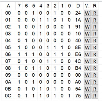

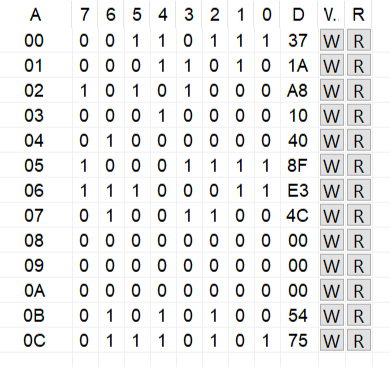

    REG Dump
    Charger Mode Verification
    Enable Load  and take measurements as follows
    Note: Without charging VBAT=3.4v,
    • VBAT= 3.5V
    • IBAT= 445mA
    • VSYS=3.8V
    • ISYS= 445mA
    • VBUS=5.07V
    • IBUS=400mA
    Change Load  to 3.7V and take measurements as follows:
    No battery, but electronics load connected as mentioned in the test setup
    • VSYS = 3.7 V (CV)
    • ISYS = 500 mA
    • IBUS = 470 mA
    • VBUS = 5.11 V
    When the battery is connected at this point:
    • The electronics load draws 300 mA
    • The battery input (charging current) is 230 mA
    • No gauge is connected; the battery is connected directly
    Can we know what is a reasonable value for the MINIMUM SYSTEM VOLTAGE would be for our battery setup?
