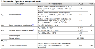

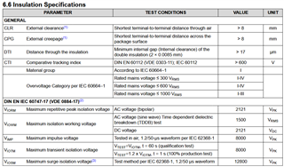

Assume we're using a standard 2 level H-bridge inverter. Given that the CMTI is within the specification, how do we interpret the insulation specifications to determine the maximum DC bus the IC can handle?
Hi Wei-Han,
Based on table 6.6 Insulation Specifications, there is a specification on the maximum insolation working voltage, which has a max DC voltage of 2121 Vdc. That is for the standard isolation barrier. Considering other insulation specifications, table 6.3 in UCC21750 datasheet shows the applied voltage vs lifetime. This maybe be helpful for selecting a max DC voltage depending on the lifetime needed for the driver.
Some other key parameters to look at is the external clearance and creepage. According to standard IEC60664, table F.5 shows the different voltages for the environment of your part. Selecting a pollution degree of 1 or 2 depends on the "sterility" of your circuit. Meaning if the device is covered in some conformal coding then the pollution degree is likely a 1. UCC21750 has a material group of 1. Based on these categories, the Vrms can be determined:
For basic isolation, it is about 1.6 kVrms
For reinforced isolation, it is about 800 Vrms
If a creepage or clearance greater than 8mm is needed special consideration may be needed.
