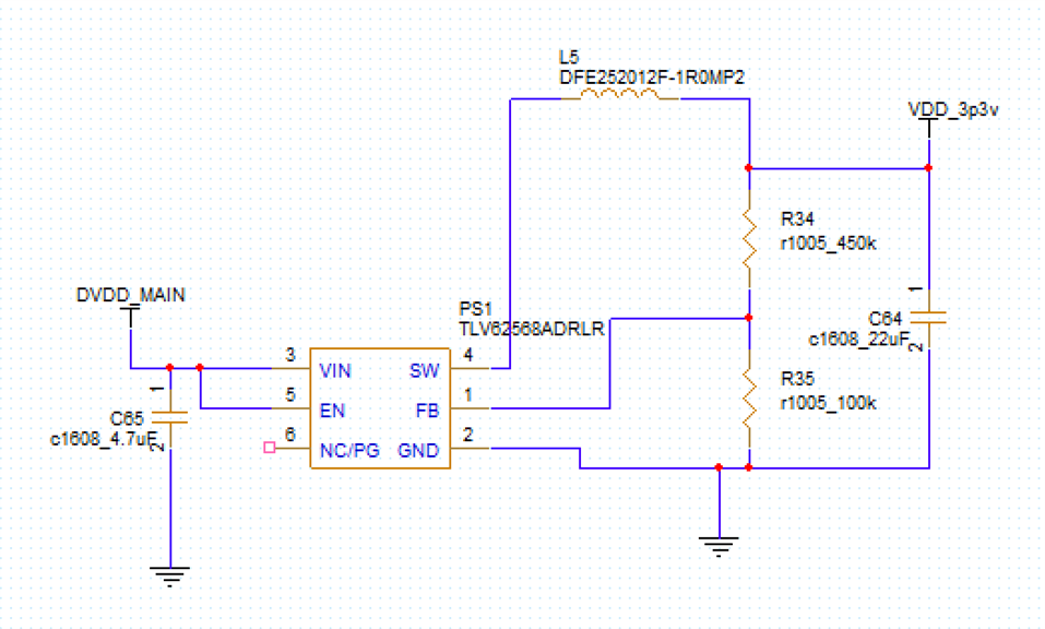

The customer configured a circuit that receives DVDD_MAIN (3.5-5.5V) input using TLV62568 and generates 3.3V.
However, in the Off state, I was able to confirm that a lot of current of 3~10mA is measured when DVDD_MAIN is input.
The product's output current is expected to be around 10mA on average when Active and less than 50 uA when Off.
Q1) Could you please review if there is a problem with the schematic?
Q2) Will this problem be solved if I separate the EN pin from the VIN pin?
Please check. Thank you.
  • Hi Grady Lee,
    Thanks for reaching out, we have reviewed your schematic which is ok. Can you clarify us what is the definition of OFF state here:

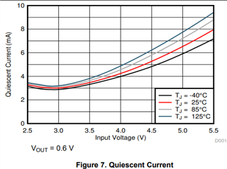

    Also, the Quiescent current of the device as you mentioned is in the range in datasheet specifications as shown which is ~3mA - 10mA (8.2.3) (page#10):

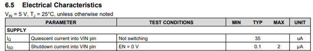

    Finally, can you tell us what is the source of less than 50uA, is it the shutdown current you are referring from datasheet which is maximum 2uA when EN = 0V?

    But, the Quiescent currency part that you confirmed seems to be the datasheet of TLV62568A.
    The datasheet of TLV62568 that I inquired about does not have the corresponding graph content, and it is listed in the datasheet as follows.

  • Hi Grady Lee,
    No worries but just for the information, the customer has used a device of TLV62568ADRLR in the schematic which means that they need to refer to the datasheet of TLV62568A. If they are using the TLV62568 device and seeing the same issue then let us know but for us it seems that they are using the other A version device which is an FPWM device.
