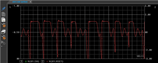

    We have tried a basic simulation recently, but it was somewhat unsuccessful. The following circuit snippet demonstrates the attempt to double/halve the voltage by simple MOSFET switch.
    This circuit has resulted in undesired behavior even in case the MOSFET was turned off. The output voltage was a way up shifted compared to the same circuit without MOSFET. Also the loop behavior has changed.
    It seems either the capacitance of MOSFET has some influence or the conduction of body diode is a problem or both - simulation shows the Rset voltage reaches negative values (w/o MOSFET).

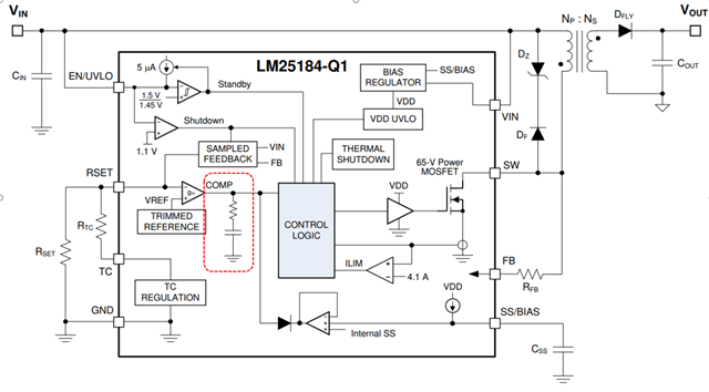

    3. Is there any way how to tune control loop response - kind of external compensation circuit ?
    It is not possible because the compensator is inside the IC and cannot be modified (see below).

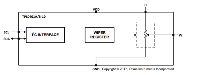

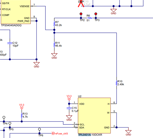

    Apologies for the incomplete answer. I reviewed the TIDU533 reference design that you mentioned and I we actually can use a similar technique to change Vout using LM5181. In the reference design, they use a potentiometer TPL0401A to change one of the feedback resistor of the buck converter. In our case we can use the same potentiometer (or similar) to change RSET resistance. The advantage of a potentiometer is that it will not add any capacitance to the final RSET resistance value.
    TPL0401A has an internal I2C Interface that you can use to connect to a MCU and control the resistance at the potentiometer.
    From the equation Rfb=(Vout+Vd)*Rset/Vref, you can estimate the min and max values of RSET to get 5V<Vout<15V. After that, I recommend to implement a similar divider than the reference design (see below). In your case, you do not need R7, but just R11, R10 and the pot. When the pot is 0ohm, you will have an Rset=~R10=Rsetmin. On the other hand, when the pot is very large resistance, you will get a Rset=~R11=Rsetmax. I hope this helps.
