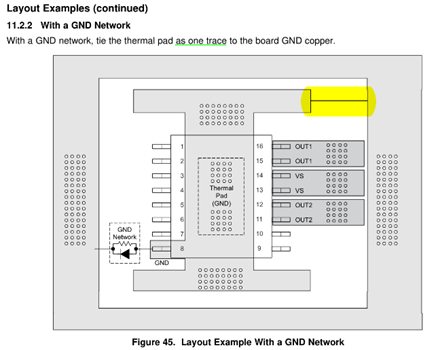

For TPS2H160-Q1, “With a GND network, tie the thermal pad as one trace to the board GND copper.
My questions:
  1. Is the trace as shown the yellow part? What is the function of this trace?

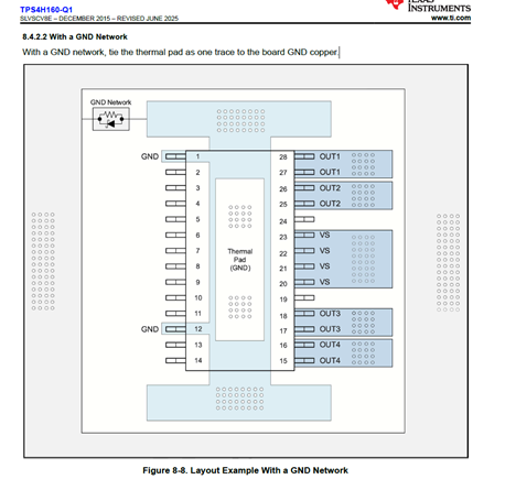

  1. Why TPS4H160-Q1 doesn’t have this trace?
