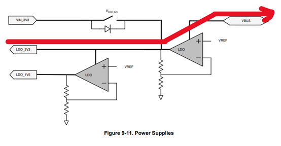

  • Hi Chris-san,
    Sorry for my reply delay.
    The customer says that when push S2 on the EVM that is TIVA's RESET switch, the voltage of LDO_3V3 is decrease to 0V and after few second, VBUS become 0V.
    In my expect, this means LDO_3V3 is connected to F_SYS_3V3 that is output of TPS76833.
    I want to know that if other 3.3V is supplied to LDO_3V3, is it possible that LDO_3V3 path become current path to VBUS like below?
    teritama
  • Hi Teritama,
    Voltage should never be applied to LDO3V3. It is an internal power supply generated by the device.
    From what I see on the schematic, F_SYS_3V3 is only connected to teh S2 pin and to the ICD_TCK and ICD_TMS nodes. It does not appear to have any connection to LDO3V3.
    Unless the EVM was damaged in some way, I don't see any obvious connections between the F_VBUS power and the Type-C VBUS and LDO3V3 pins.
    Is the customer able to evaluate the EVM with the micro-usb disconnected? It should not be required to see the TPS25750 standalone behavior.
    When trying to replicate this issue on an EVM, I do not see any voltage on VBUS appearing or disappearing when the micro-usb port is connected and disconnected. It stays at a constant 0-V.
