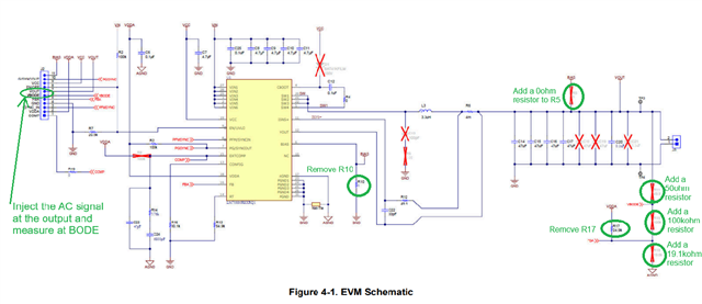

  2. I want to capture Bode plots at various input voltages and output loading conditions. The EVM user manual is unclear about how to capture these. I have a scope with a frequency response analyzer Is there a guide on how to run this test with this EVM?
    The LM70880-Q1EVM is not setup to run bode plots because the IC is setup for a fixed output voltage option. You would need to modify the EVM. See below:
    To measure a bode plot, you will need to inject an AC signal by "breaking the loop". See link below for more details on how to measure a bode plot.
    https://www.tij.co.jp/jp/lit/an/sluaa51/sluaa51.pdf
