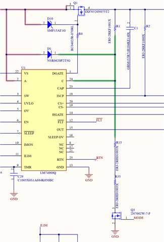

Hello!
I'm working with the LM74912-Q1 ideal diode controller in a high-side switch application. By default, it blocks reverse current using its built-in gate control logic. However, for my use case, I want to allow reverse current flow under certain conditions — essentially using the external MOSFET as a bidirectional switch, not as an ideal diode.
My idea:
  • Insert a resistor between the C pin and the MOSFET drain
  • Add an external N-MOSFET as current sink from the C pin to GND  - when current sink enabled - it would allow me to artificially create a condition where V_A (source) > V_C (gate), turning on the MOSFET manually and allowing reverse current
Will it work?
BR,
Artem
