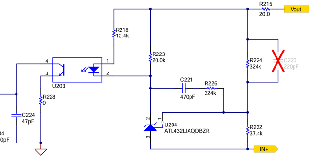

    3. Sorry about the confusion. My current understanding is that the FBreplica is followed the by Vcomp during normal operation for control effect( after soft start has been completed), which determines the Vth_L and Vth_H for the VCR pin. While the generated threshold will affect the switching frequency, the feedback circuit I have operates the shunt regulator in comparator mode. So the optocoupler photon diode basically goes from off state to very bright state when the voltage of the shunt regulator change from (Vout - Vopto_diode) to 2.5V, which mean the amount of current sink from the FB pin can change from 0 to a very big amount. This would directly trigger burst mode in this state. I wanted to check if my through process was correct to reinforce my understanding of the chip and the circuits. I used the same circuit from PMP21160 reference design but without the 20ohm R215. The IN+ is same as the output ground.

    please check R215, R218, R223 is used for providing required bias current to U204, other components are used for compensation. Please finetune your components accordingly.
    Sougata
