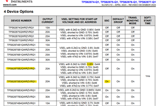

Could TPS62875B2QWRZVRQ1 be configured SSC enabled via I2C? TPS62875B3QWRZVRQ1 could not be used because it does not have 0.85V start-up voltage. We need 0.85V start-up voltage for SoC requirement, but want to use spread spectrum.
