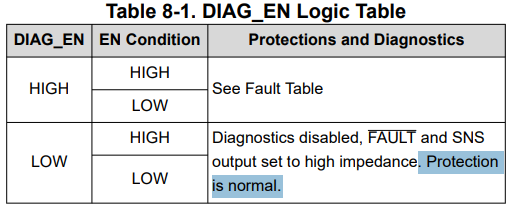

1. Regarding the operation of TPS1HTC30-Q1, What is the protections enabled when DIAG_EN is LOW? The sentence in Table 8-1 lists Protection is normal only, so users cannot understand what kind of protections are enabled.
Could you please kindly fill out blank space in the table below?

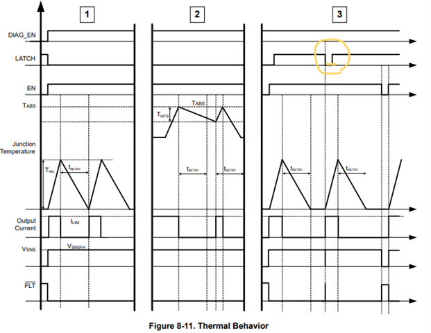

2. Regarding the Latch-off mode of thermal protection behavior, I understand that users need to toggle(H->L->H) the LATCH pin or EN pin to enable the channel. How long is the duration of low period required to toggle? Any specifications?

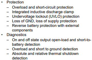

    1. Protections normal means the following features under "protection" below are still available but features under "diagnostics" are not. When DIAG_EN is low, faults are not being reported.
    2. There is no specific time requirement, just enough time to turn the pin logic low and then high again.
