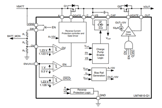

LM7481-Q1: Oring Design
Part Number: LM7481-Q1
Hi team,

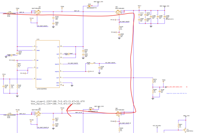

My customer are using LM74810 for their project, SCH as attached: VBAT_ORing_0710.pdf
They asked if consider the condition that 2 input are alive at the same time, can they remove the D245, D246 and connect the 2 VBAT_MCU_12V0 net directly? Will this have side effect to Q32/Q92 and oring function?
If EN is 3.3V and VBAT exceeds the OV threshold, HGATE will pull low and turn off Q2, right? Will DGATE pull low and turn off Q1 in this condition?
