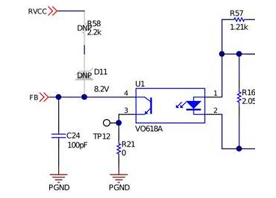

When we looked into where the efficiency is leaking we observed that in LLC side the bottom mosfet in Half bride is heating up a lot and when observed the Vds waveform of bottom mosfet it is operating in burst mode always even when load is increased. The LLC circuit is implemented as same as that of UCC25640EVM-020 circuit except the resonant inductor and transformer which is from different manufacturer but same value. We also made sure the new Lr and transformer is not lossy.

    We tried to disable the burst mode using BW pin resistors programming, we got the gate pulses continuous but the output voltage is out of regulation. So when FB pin is probed the voltage is observed to be zero and it is kind of going to open loop mode.
    We are suspecting that it could be optocoupler bias current issue. Since in UCC25640EVM-020 Eval kit VO618A opto is been used which has CTR range of 50% to 600% Whereas we are using ISOM8110 optoemulator whose CTR range is 100% to 155% range. Is there any way that I can bias the optocoupler collector side connected to FB pin of ucc256404 IC to operate in that CTR range. What's your recommendation on biasing that and how to choose the bias current for collector (like in case of resistor and zener diode biased from RVCC in PFCLLCSREVM-020 Eval kit) ?
  • Hi, If FB pin voltage is observed near 0 voltage, Can you please try adding a ~2.2kΩ resistor and 8.2V Zener in between RVCC and the FB pin of the controller. It should help limit the swing of the FB signal due to delays from opto-coupler saturation.
