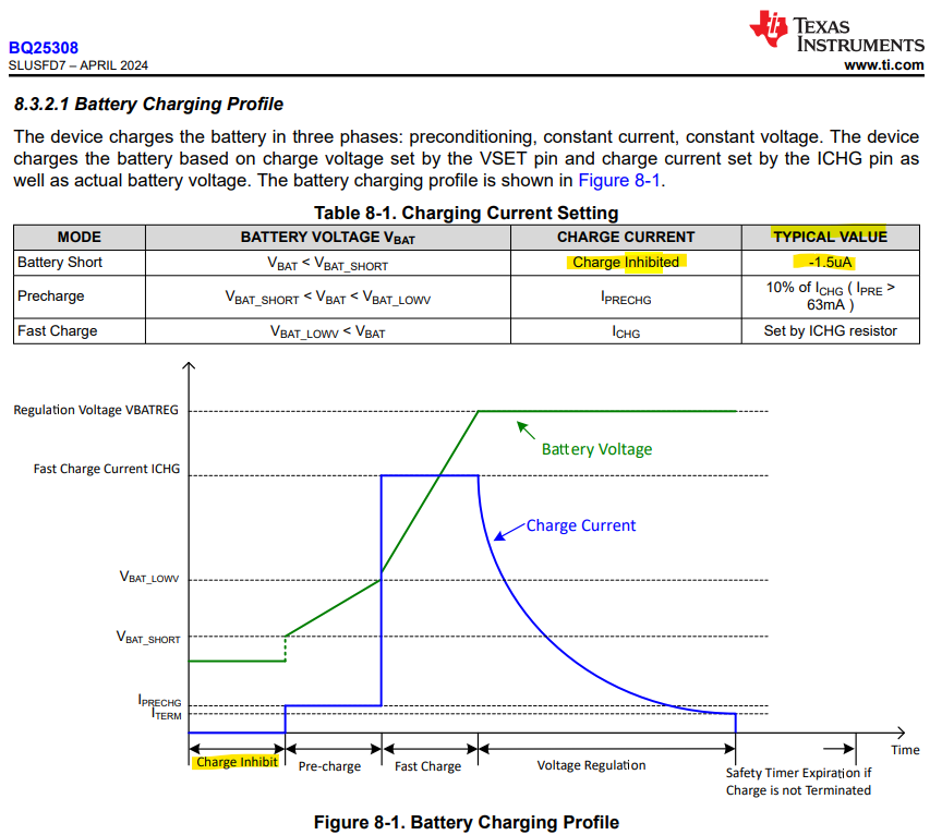

The customer is reviewing the BQ25308, and the battery used is 1 cell, lithium polymer.
The customer said that he conducted the test after forcibly discharging the battery completely, considering the possibility of natural discharge later.
Currently, when the battery is completely discharged, the 3rd pin (STAT) of BQ25308 is repeatedly going from low to high to low to high.
It is shown as Fault mode of STAT pin.

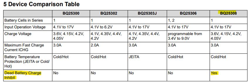

If the battery is completely discharged, does it not charge?
Is there a way to charge a completely discharged battery?
