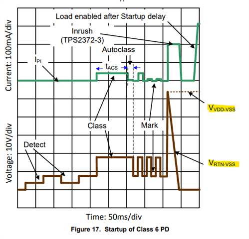

  4. On the faulty board, I measured the voltage between VDD and VSS of the TPS2372. The scope captures are attached. It mostly shows the small triangle waves but occasionally jumps to the larger waveform.
Could these VDD-VSS waveforms indicate an internal failure in the TPS2372? Any insight would be greatly appreciated. I can provide more details or schematic snippets if needed.

    You can disconnect the TPS2372's downstream circuit and measure VDD-VSS: a typical waveform could be like below: detection (2.7 - 10.1V), classification (14.5 - 20.5V)
    It could be possible a device internal failure. An A-B-A swap is usually recommended for verify if the unit is bad: test the "bad" unit on a known good board, then test the known good unit on a "bad" board.
