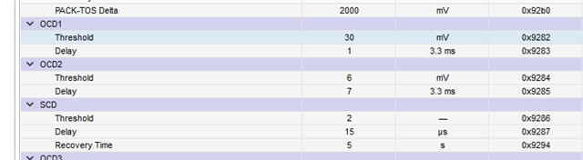

We designed a 13S battery using the BQ76952, while the battery seems to be fine on a linear load it's not able to power a capacitive load. It's triggering OCD1 (which is set to 30A, using a 1mR resister) right at power-on. Attached is the schematics for reference.

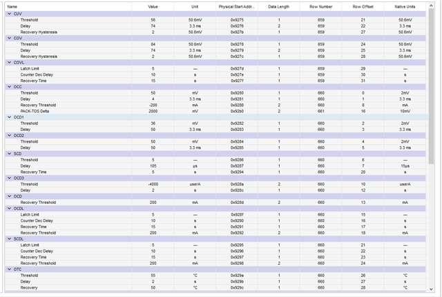

  • I have tried increasing the thresholds of all the protections and also removing them. But the BMS is struggling to power a simple load (we haven't even connected our motors or mother board yet).

    What is the total capacitive load that the battery is trying to power up? Is there any series resistance to this capacitive load to limit the start-up current (ESR or explicit resistance)?
    Do you have any waveforms showing the current pulled from the battery or the current/voltage of the capacitive load during power-on?
    With a very large capacitive load, the start-up current may be very large and be sustained for a significant amount of time until the capacitive load is charged up.
