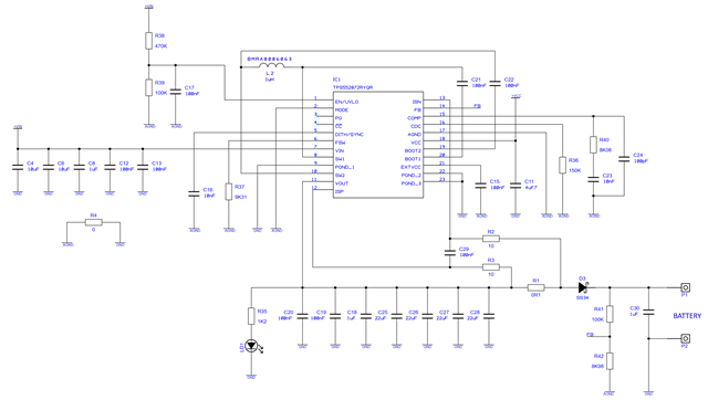

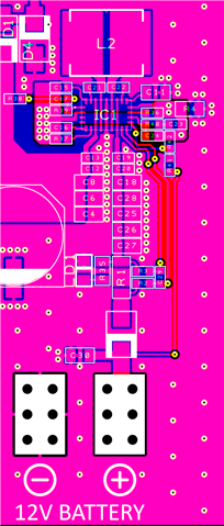

we designed a simple charger for a 12.8V LiFePO battery using a TPS552872.
Below you can see the schematic and PCB layout.
We set a charging voltage of 14.8V with R41 and R42 (from the battery datasheet) and a current limit of 500mA with R1.
The input voltage (+VIN) is about 13V, so the regulator works in step-up, until it limits the current.
We set a current limitation in case we wanted to charge an almost completely discharged battery.

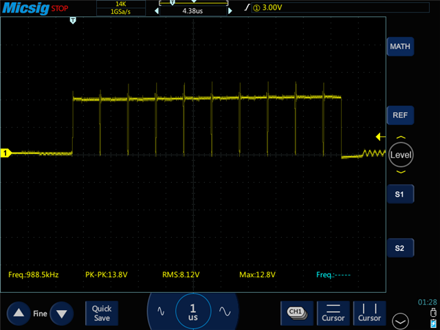

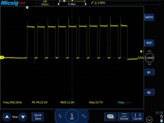

Figure 1 shows the SW2 signal at 550mA; Figure 2 shows the SW2 signal at 600mA. For higher currents the signal remains the same.
I tried changing the operating frequency by changing the value of R37, but nothing changed. I also tried different values of inductance for L2.

    There's one error in your schematic. The EXTVCC pin should be connected to either VCC or GND, it should not be only connected to a cap.
    For the test, you should use the constant voltage mode of the e-load, instead of constant current mode. Please try this and see the result.
  • Hi Shipeng,
    thank you for your reply.
    The datasheet says the EXTVCC pin can be left floating to select the internal regulator, anyway I connected the EXTVCC pin to the VCC pin with a wire to select the internal regulator.
    The behavior remained the same.

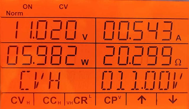

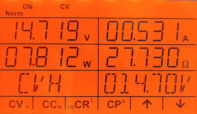

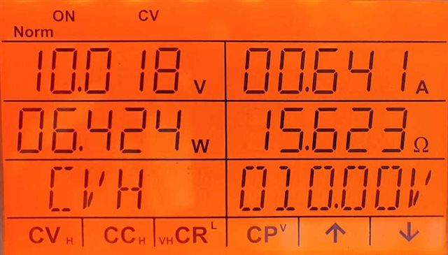

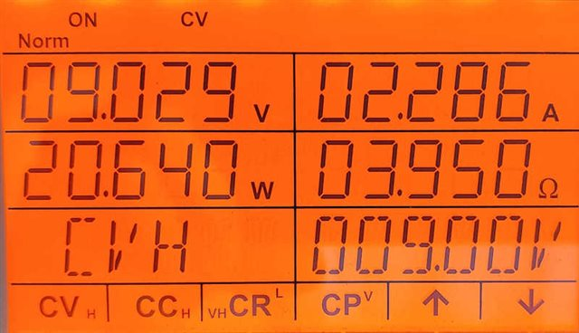

    As you suggested, I set the electronic load to constant voltage mode and below you see the measurements at different voltages.
    When the voltage drops below 11 volts, the current starts to rise. At 9 volts it goes up to over 2 Amper!
    This is because the regulator does not go below 9.2V.
    I think it is clearer when using the electronic load in constant current mode.
    Set 14.7 V
    Set 11.0 V
    Set 10.0 V
    Set 9.0 V
    Could you measure SW1,SW2, and inductor current waveform when Iout is in control and out of control? Thanks.
