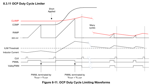

I am confused by the current limiting functionalities of the LM5146 DC/DC Buck Converter.
From what I can understand, there are two modes of over-current protection offered by LM5146: hiccup mode in which the buck converter shuts off after a prolonged over-current event, and the cycle-by-cycle current-limiting feature in which the duty cycle is shortened in the event of an over-current event as shown in the diagram above. I interpret the latter as a constant-current mode feature and would like to use that to charge a battery. However, my design seems to go into hiccup mode every time without trying to limit the current when connected to a battery. Is the LM5146 able to act as a CC/CV device with only a voltage feedback loop?

  • Hi Taru,
    Thanks for the recommendation. I will take a look at that in my next design.
    But my question remains. Is the LM5146 able to limit its current to that set by the ILIM before hiccup occurs, akin to constant current mode? If so, what might be the cause of a hiccup being triggered without current limiting being observed?

  • Hi Benjamin,
    The current is limited before hiccup occurs by reducing the on time - however, the device keeps track of how long this occurs - if it happens for 128 consecutive cycle - the device will go into hiccup mode (if the overcurrent condition is not removed) and do a soft start sequence - hence this is not a true constant current mode.
    Can you share your waveforms that you may have captured - I am not sure if this will happen - Meanwhile, I saw in the other post where my colleague Tim had recommended you to change the ILIM setpoint - have you done that?
