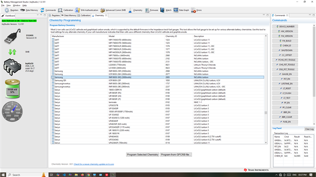

1. Despite configuring as above, I cannot find an exact chemistry match for Samsung INR21700-50S in the Chemistry ID list.
   - Which Chem ID do you recommend for INR21700-50S with BQ40z50?

    1. Despite configuring as above, I cannot find an exact chemistry match for Samsung INR21700-50S in the Chemistry ID list. - Which Chem ID do you recommend for INR21700-50S with BQ40z50?
    To receive an adequate match for the cell in use, please use the GPCCHEM tool. This will allow for us to match the cell in use with a chemID in the data base.

    2. I am preparing this setup for the production phase: - What are the next steps for properly finalizing the BMS for production?
    Once the chemID has been chosen, a learning cycle will be required to be conducted. This will allow for the gauge to learn all the necessary information about the cells in use. Once this has been tested with the application, the golden image can be pulled from the device using bqStudio then used in production to program other units.
