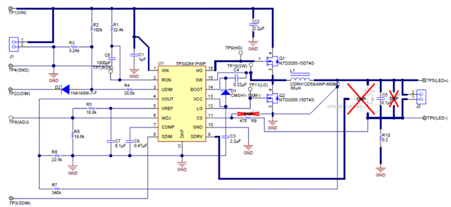

  • Hi Kazuya
    For the low level of UDIM, please apply voltage between 0.37~1.27V, as the schematic in the EVM user guide.(the diode clamp UDIM ~0.6V instead of 0V)

  • Hi Kazuya
    I checked EVM and there did has ~30ms to restart and output Iout.  You can add a diode as the EVM does.
    Thanks and best regards.

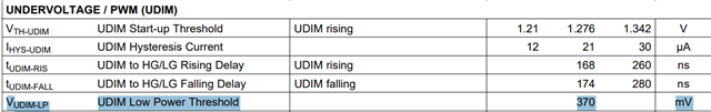

    As an additional customer question,
    they want to know the minimum/maximum voltage of UDIM Low Power Threshold.
    Could you please give me the voltage or percentage (for example, the min/max is +/-10% of typical value)?
    Your reply would be much appreciated.
    Thank you again and best regards,
    Kazuya.
  • Hi Kazuya
    The datasheet only has typical value, and this is an old part I can't find the max/min value.
