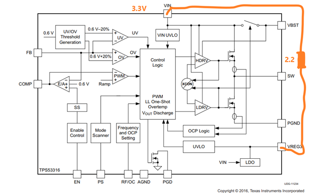

Hi team,
If the Input is 3.3V, output is 1.8V, can we connect VIN to VREG3 by 2.2Ohms resistor? I know VREG3 is LDO output, but still want to know if it is OK.

Hi Naizeng,
You are not allowed to connect VIN with VREG3! This are 2 outputs with different voltages.
