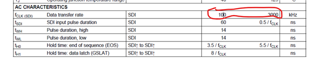

  • I have few updates on that. The measured cycle of two rising edges was 10.26 us in the SDI line. As per the datasheet, we need to get 0.33 to <=10 us. Am I right?
  • Hi Ramesh,
    Based on the spec on datasheet, the supported minimum data transfer period should be larger than 10us.
    Have you tried to decrease the period to have a test again?
    Felix
  • Hi Felix,
    I configured in code the interface with STM32L4P5ZGT6. The system clock was 80 MHz. Hereby, I attached a code and settings below. Still I am facing LED blinking issue.
    Please go through it.
    Data rate 320 kHz 100–3000 kHz
    Bit period 3.125 µs 1 / 320 kHz
    Reset pulse 100 µs >80 µs min value
    EOS hold 20 µs Conservative padding 2 bits (0 0)
    GSLAT pulse 30 µs  min value
    Manchester 1.56 µs half-bit 50% duty cycle
