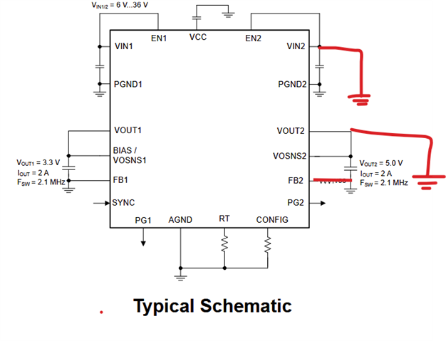

Hello dear TI Team,
I'd like to use TPSM64406 chip but I don't need as much as 6A current for my particular application.
Is it possible to use the chip in dual mode (config resistor either 0 or 120k) and tie the second DC-DC to ground?
Thank you
    This device can be configured into single output mode utilizing the schematic depicted in figure 7-3 of the datasheet.
    More information on the specific pin requirements and components are listed in both the pin function table 5-1 and the application section 8.
    Thank you,
    Joshua Austria
