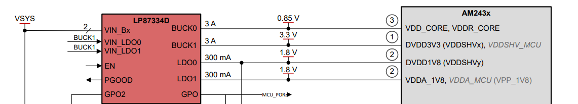

We have a project where the VOUT_LDO0 and VOUT_LDO1 pins of the LP87334DRHDR are shorted together. Could you please confirm this configuration is acceptable or have any concerns regarding the same?

  • Hi Vaibhav,
    This is not recommended.
    Technically, both LDOs have the same output level and timing sequence, but they are not intended to be shorted together.
    Since they are still operating independent of each other, I would strongly advise against this so that one output may not adversely effect the other.
    What are the LDOs connected to?
    Are they powering multiple rails or a single output?
    Multiple rails can be divided among the two LDOS.
    Or if only one LDO is needed, then the other can be left floating.
    Sarah
    LDOs will connected to AM2432 power rails.
    It's powering multiple rails; however, having two separate power plans makes the layout complex.
    Could you please let us know what potential issues might arise if the outputs of two LDOs are shorted together?

  • Hello Vaibhav,
    Thank you for the context.
    Primary concern would be the current draw.
    Current sharing between the two LDOs may not be equal if there is even any slight discrepancy in the output voltages.
    And as load current increases, one could reach overcurrent limit and cause voltage drop.
    This has not been tested on our end, so generally it is not recommended.
    There is a general app notes on using ballast resistors to help balance load current
    https://www.ti.com/lit/wp/sbva100/sbva100.pdf
    But again, this has not been tested with the LP8733 LDOs specifically.
    The design guide for LP87334D powering AM243x shows both LDOs having separate rails, this is the recommended connection:
    Sarah
