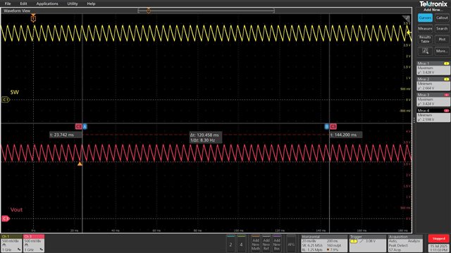

  • ok so I updated the compensation loop, removed CFF, and it looks like its not regulating properly.
    Here are something other things that I checked:
    1. The feedback resistor is set correctly, so even though the output voltage is oscillating, the oscillating voltage of the feedback divider is the correct ratio.
    2. I checked the compensation loop, and while there was a cold solder joint, re-soldering the comp pin resulted in the compensation pin and the compensation passives to see the correct voltage. Around 2V.
    Then when I measure the switch node, it looks exactly like output voltage. A triangle wave that oscillates between 2.5V and 3.5V, which you can see below. The switching node is not switching properly. I haven't had the chance to swap the component, but I wanted to double check to see if there is anything else that I am missing. the RT resistor is set to the right resistor value so Im not sure why I would see this kind of switching behavior unless there was an issue with the internal driver.
    Thanks!
    Albert
  • Hi Albert,
    Thanks for the additional details.
    Can you confirm that the voltage at the feedback pin is greater than 0.804V? It should be if your feedback divider is correct.
    Can you also confirm that you are seeing ~2V on the COMP pin? If so, that is extremely high and could be a cause / additional symptom of whatever is happening. If you are seeing such a high voltage on COMP, can you please check for tin-whiskers, solder bridges, schematic mistakes, or anything else that could be causing external current to be making its way onto the COMP node?
    Does the COMP pin also show this slow triangle wave pattern?
    Andy
  • Hey Andy,
    I took a look into it since there was some cold joints that I had found on the COMP pin that was causing some issues with the connection. So I re-soldered all the pins and the PoL is now working!
    My guess is that the RT pin was probably floating and not connected properly which is why the PoL was not switching properly.
    But thank you for your support.
    Albert
