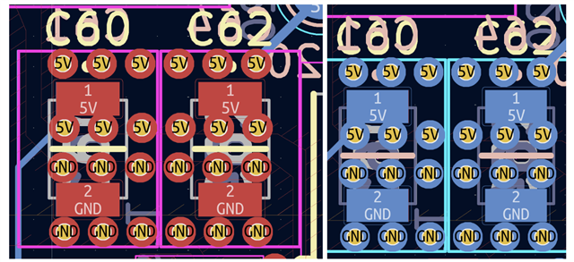

    I have designed a custom PCB using the TPS54KC23RZR for a 12V input to 5V / 20A output application. I am experiencing a very loud, high-pitched audible noise (whining) from the converter stage, which seems to be related to instability.
    The noise can be slightly dampened by physically pressing down on the PCB near the output capacitors, which strongly suggests a mechanical vibration from a component.

    I have been investigating potential causes, and my main suspicion lies with my implementation of the feedback and ground sensing connections, especially when compared to the recommendations in the datasheet and the EVM layout. Could the audible noise be caused by an incorrect feedback sensing layout, specifically how the GOSNS (pin 13) is referenced?
    My Current Layout Implementation (see attached layout screenshot):
    • The GOSNS (pin 13) is connected to the main power ground plane (PGND) locally, near the IC.
    • The bottom of the feedback resistor R25 is also connected to this local PGND.
    • The feedback traces for FB (pin 14) and GOSNS (pin 13) do not form a differential pair routed to the point of load. It is a local sensing configuration.
    I have attached screenshots of my schematic, my PCB layout around the IC, and a reference layout from the datasheet for comparison.

    Our PCB

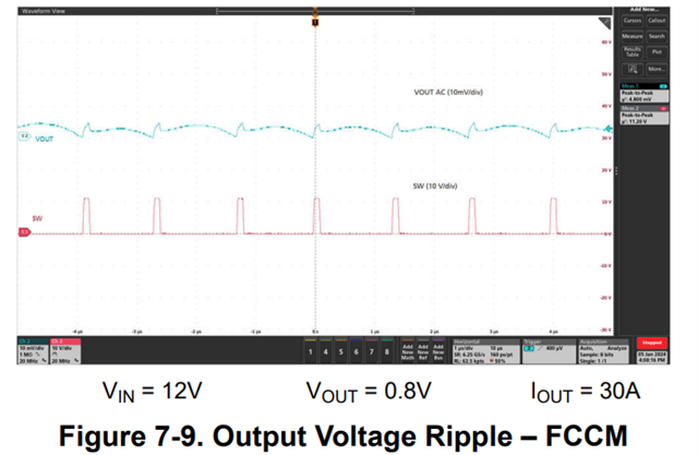

    It would be helpful to see the oscilloscope waveform of VOUT and the SW node as shown below. This will help us determine if the circuit is unstable.

    Thank you for your suggestions. I've performed the tests and have attached the waveforms you requested.
    Here are the key findings:
    • Capacitors: We are using 6x Murata GRM32ER71A476KE15L (47µF, 10V, X7R, 1210). We noted the EVM uses X6S, but we could not source a 10V-rated X6S part, as available options were 6.3V or lower.
    • Heavy Load (~80W): The SW node is clearly unstable and not periodic. Output ripple is high at ~400mVp-p.
    • Light Load (~8W): The SW node becomes periodic and the audible noise is much lower.
    • Mechanical Test:
      • Securing the PCB with standoffs (it was previously uneven on the surface) reduces the noise.
      • Our layout has 3 output caps on top and 3 on the bottom, directly opposite each other. Removing the 3 bottom capacitors also reduces the noise. We are unsure if this was due to the mechanical change or the electrical change from halving the output capacitance.

    3. Regarding our mechanical test: Could our specific layout with capacitors on both top and bottom layers directly opposite each other amplify the audible noise on the PCB?

    What is the more likely cause of the instability: the 680nH inductor value being too high, or insufficient effective capacitance?
    Are you able to measure a Bode plot? Your phase margin might be too low, which could be causing instability. Try switching to RAMP2 or RAMP4 to see if that resolves the instability.
    I'm not familiar with that specific issue, but you could reach out to the capacitor manufacturer for more information.

    Thank you very much for your advices, we will implement everything we have learnt with this conversation. I was able to change the MSEL to 30.1k, which sets a switching frequency of 1400kHz and uses RAMP4. This has removed the noise even with high loads (80W).
    Would this configuration be valid for us? Our ripple looks like this now:
  • Hi Pablo,
    Yes, that is a valid option if you're willing to go to a higher switching frequency.
