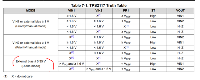

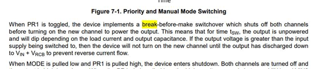

Regarding this TPS2117, when I was testing to turn off the VIN1 and VIN2 channels of the TPS2117, I found it ineffective.

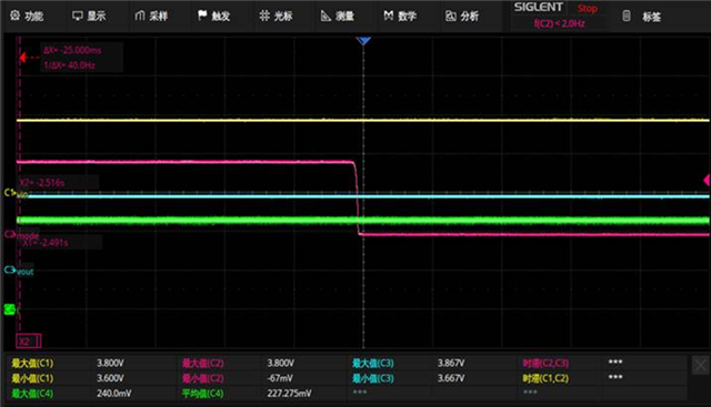

Refer to this waveform diagram: Among them, the yellow indicates that VIN1 has also simultaneously raised PR1.  When MODE is lowered, the blue VOUT output still exists.  Green represents the output current.
May I ask if there are any other conditions? What kind of problem should this be and how can it be solved?

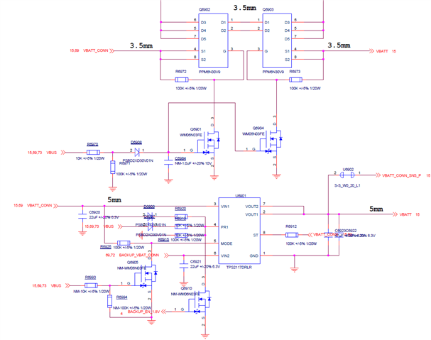

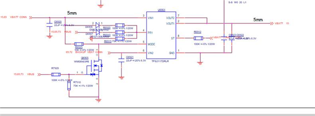

Could you please help me check again if there is any problem with the circuit
The overall circuit, with a bypass charging Pmos back-to-back circuit. From VOUT=>VIN
