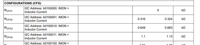

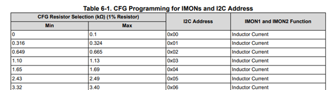

#3. It is not related above questions but there is gap about I2C address between d/s page10(5.5 Electrical Characteristics - CONFIGURATIONS) and d/s page 15 (Table6-1). Which is correct address?
b0100000 = 0x20...

    3.This is a known issue. The address is 0x20, ...

    3. Understood that D/S p10 is correct information - Am I understanding right?
     -> Additional query, the customer tried communicate with EVM. They use 2 boards and a board is operate as SYNC host and other operates as SYNC slave for multi phase operation. In this case, master can communicate via I2C only with using 0x00~0x07 address, but slave device can with 0x20~0x27. Does it what you expect? Is it decided by SYNCO/I? Please check it and make sure that.

    3. We were using 0x00~0x07 before RTM. So, for old EVMs, you may have 0x00~0x07. But you will only have 0x20~0x27 in the future.

    3. Clear.
