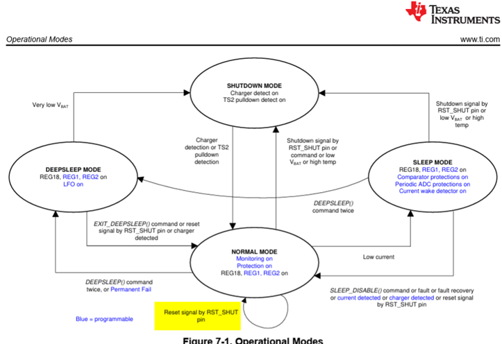

Hi team - I have a question about the partial reset behavior using the RST_SHUT pin.
Based on the datasheet, it appears that asserting this pin for less than 1 second triggers a partial reset of the device.
- Could you please confirm if there is a deterministic minimum assertion duration required for the chip to reliably detect and execute this reset?
- Additionally, I would like to understand how the I²C engine of the device is affected during or after this partial reset. I was unable to find this information in the technical reference manual—apologies if it was overlooked.
