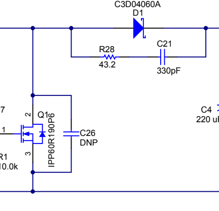

  • In general, the noise in this freq range is coming from high dv/dt and di/dt on the switching node.
    Please try to minimize the current/voltage loop in layout and consider adding or modifying the snubber components shown below. The FET selection also plays important role here.
    Ning
  • Dear Ning, Thank you very much for your feedback.
    Taken trails with RC snubber across Boost diode ,
    1. R = 44E, C= 330P
    2. R = 44E, C = 100P  ( As Cj of Diode is 20 pF)
    There is no heating of snubber Resistor observed during testing.CE Observation PFC 650W ( UCC28180) RV02-21072025.pdf
    CE Results are fail in the Frequency range of 3 to 5 MHz and at 14 MHz. Please refer the  CE Scan
  • If the snubber is not effective, we need to dig deeper.
    EMI is a system level issue. Layout and filter component selection play big role here.
    Can you share their layout and BOM selection?

    Firstly, the TIDA-00443 reference design CE results are compliant with Class A levels of EN 55011 (Group 1) as noted in the text paragraphs above Figures 33 and 34 in the Design Guide and the limit lines within the CE figures.  The figure captions for Figures 33 and 34 incorrectly attribute compliance to Class B limits.  The CE results for TIDA-00443 do not meet Class B limits.  The captions contradict the text and the captions are wrong.
    The RC snubber trials which you performed on your design used values based on the TIDA-00443 design and its schematic.
    In your test results there is small but noticeable increase in ~14MHz QP noise in Trial 2 (with 100pF) compared to Trial 1 (with 330pF).
    This indicates that the snubber across the boost diode does have some influence on the high frequency noise, but not enough for your system.
    The snubbing for your system should be tailored to the components used in your system, not simply a copy of the TIDA design unless you are actually using a all the same components of the TIDA design.
    I suggest to also consider adding a snubber across the switching MOSFET and modify the dV/dt and/or dI/dt associated with the MOSFET switching.
    For snubber resistor temperature rise, I expect the power loss to be = 1/2 * Csnub * 400V^2 * 70kHz = ~1.85W with 330pF cap.
    A 2W-rated resistor should definitely become noticeably hot with that much dissipation.
    Please check your snubber connections to make sure that the R-C is actually attached across the diode.
    Also check the resistor value to verify that it is(was) 44ohms and not some value much higher by mistake.
    Ulrich

    All that said, I suspect that the 14MHz noise is likely to correlate to the dv/dt of the MOSFET drain.
    This dv/dt, coupling through the winding capacitance of the boost inductor, may be injecting HF noise currents onto the input line, which your EMI filter is not effectively blocking.  This is only my suspicion, not an actual diagnosis, but I suggest to follow up on these points to see if you can mitigate the noise.

  • Hello BR Kadam,
    I have to reiterate that your questions are beyond the purview of this forum.
    I recommend to conduct a Google search on "RC snubber design" and check out the many responses that address this topic.  Some from TI and many from other companies.   The same can be said for searching for EMI filter design.
    Keep in mind that the purpose of an RC snubber is to dampen ringing of a series L-C network or a parallel L-C network.
    In a PFC topology, the ringing is typically due to a series L-C network, but not always.  The optimal damping resistance value depends on whether it is series or parallel.
    The choice of snubber capacitance is usually 3X the value of the total capacitance on the ringing node. The total capacitance is the sum of the MOSFET, diode, inductor, and stray capacitances.  Also, semiconductor junction capacitances can be highly non-linear, and should not be assumed to be a single value form the device data sheet.   Find the capacitance curve for each part and get the value at the voltage where the ringing happens.
    Don't assume that your EMI filter components are ideal.  Each part has parasitic elements that degrade performance at certain frequencies.
    Inductors (CM and DM) have winding capacitance that allow high frequency currents to by-pass the inductive impedance.
    Capacitors (X and Y caps) have lead inductances that inhibit the conduction of high frequency currents through them.
    Undamped L-C ringing within the EMI filter may exaggerate certain noise frequencies.
    All of these aspects should be considered and investigated to optimize a filter's effectiveness over the full conducted-EMI range.
