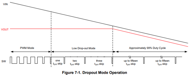

    Q3. In the figure below, what is the voltage difference between input and output for the LDO mode operation? Could you explain each case separately when the input voltage is 48V and the output voltage is 30V and 10V?
    Low Drop-out mode happens when the Vin drops and comes closer to the configured output voltage. So in your case - if input is 48V - the device will work normally for 30V and 10V outputs. For the 30V case - if the 48V falls towards 30V - the device will start getting into Low Drop-out mode (to regulate Vout) - if it falls further (below 30V) - the Vout tracks Vin(with 99% duty cycle). Section 7.3.1 explains this in detail.
