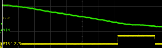

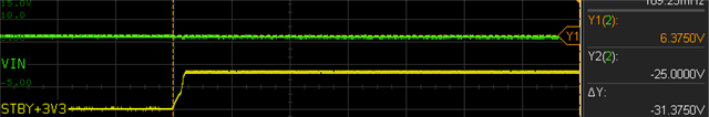

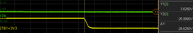

Hi TI support team,
I have some experiment to try with TPS25730DREFR. The idea is to use a external supply to power up instead of usb-c cable and vary a voltage level to see at what voltage a DUT will cut-off.
But my issue is the sink path is flow only in a range of around 3.6V-6.6V, refer to my result below even though my ADCIN config is 5V -20V and everything working just fine with a usb-c power adapter.
Note : STBY+3V3 is a VCC for local MCU.
My question is what could be a factor that block the internal FET and how can it's work at a 3.8V - 6.5V range?
Nitipong

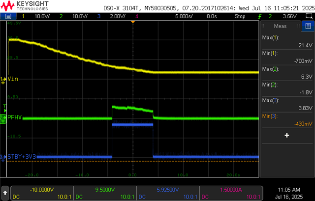

  • Hi Chris
    Sorry for the confusion, This is a result measuring with PPHV.
    Please ignore a STBY+3V3 at VIN3V3 pin since I cut that trace already. STBY+3V3 is a source for local MCU which I use to see if DUT is on or not.
    I'm measuring it while decreasing a VBUS to the point where DUT will cut off. My current condition of CC pins are both pull up to a VBUS. I understand that the sink path should be disable by using only an voltage supplying only.
    But my curiosity is why the PPHV is enable in a voltage range I refer above only.
    Nitipong
  • Hi Nitipong,
    On initial connect, the TPS25730 first looks for pullup resistors on the CC line, and then will check the VBUS voltage to make sure it is in an expected range around 5-V.
    3.8V - 6.5V
    UVP at 5-V is expected to be around 3.9-V. At 5-V, seeing OVP trip at 6.5V is not unexpected either.
    Basically, on initial connect we expect to see CC voltage and VBUS around 5-V before we enable the power path. The 3.8-6.5V operational range is within the expected range for VBUS. Ideally, VBUS should be at 5-V though.
