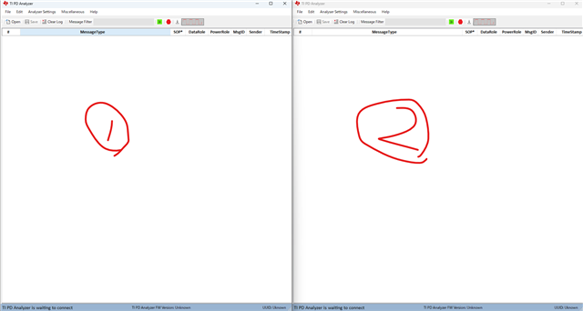

My customer wants to measure two TI-PD-ANALYZER with GUI in one computer so that they can use the same time stamps for the two ports. When they use two computers for the two ports, they cannot use the same time stamp.
When they use two instances of the GUI, is this achievable as shown below? Is each TI-PD-ANALYZER automatically assigned to each GUI instance?

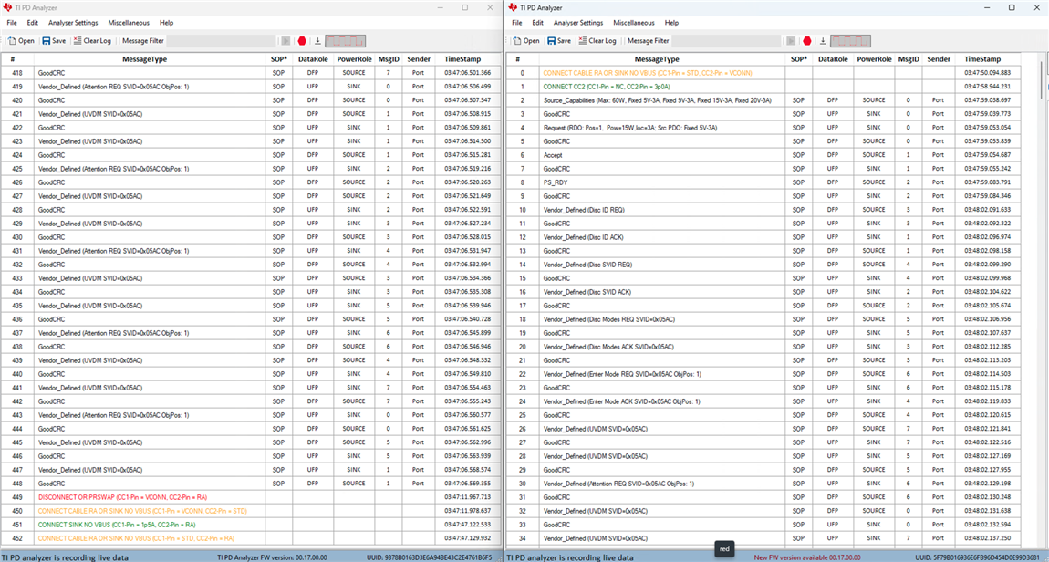

    Yes this is possible - see screenshot below showing two GUI instances and two TI-PD-ANALYZER's connected to the same PC:
    In the GUI, after connecting the analyzer, clicking "Analyzer Settings" --> "Connect to analyzer" will connect it. You can repeat this in the second GUI window after coencting the second analyzer.
