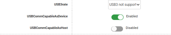

1. What does USBCommCapableAsDevice/Host indicate? If we only enable "USBCommCapableAsDevice" does TPS25763-Q1 only accept UFP data role? Or is there another meaning?

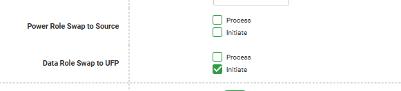

2. What is the difference between initiate and Process of data role swap to UFP? Can we configure TPS25763 to only UFP as datarole and source only for power role? if yes, please let me know whole relative settings we need to configure.
    This directly correlates to the "USB Communications Capable" bit of PDOs (bit 26).
    Process means we will swap to UFP if the other end of the cable requests a role swap.  Initiate means we will immediately request to swap to UFP if we connect as DFP.
    Per USB spec, a power source must initially assume the role of data host.  So we would need to check both Initiate and Process swap to UFP.  Note the swap is only succesfull if the sink agrees.
