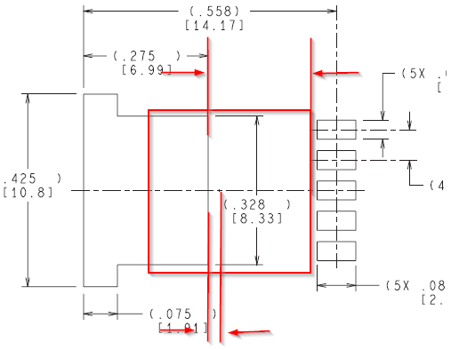

could you help me check below size of red circle?
is it half of .558[14.17]?

Hi Brian,
Can you please note where you are getting this document from? The correct package dimensions and drawings can be found in the datasheet on pages 43-46.

Hi Joshua
I just check latest datasheet on TI. com
https://www.ti.com/product/zh-tw/LM2596
it doesn't mention red circle part as above.
could you help me check it?

Hi Brian,
The 0.558 dimension should be bisecting that 0.085 pad. From there you should be able to do the math to figure out what that dimension is.
0.558 - 0.085/2 - 0.275 = 0.2405.
Ultra librarian should also have this land pattern for reference if you have any additional questions.

Hi Brian,
All part dimensions should also be listed in the datasheet or the "Package | Pins | Size" section on the product tool folder.
