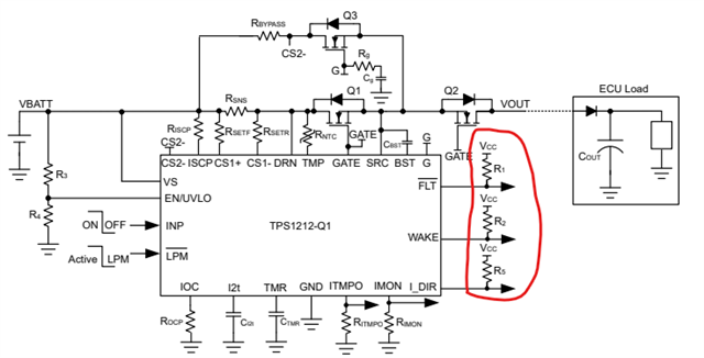

Hi expert,
My customer (CosMX) is designing TPS1212-Q1 schematic. Could you help to recommend the pull up resistance of FLT, WAKE, I_DIR? Thanks.

Hi Ryker,
On the EVM the pull up for FLT is 3.16k ohms, The pull up for wake is 10k ohms, and the pull up for I_DIR is 3.16k ohms.
