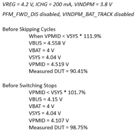

Could you help to provide the maximum duty cycle of BQ2538 for charging battery? Thanks.

Hi Kailun,
The max duty cycle of BQ25638 depends on the testing conditions as mentioned below:
