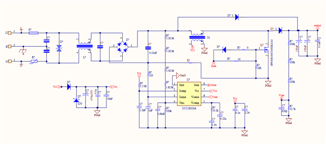

I want to use the boost inductor with a 12V bias to supply the VCC in UCC28091A , is it ok ?
Please give your advices ?

You can do that but you need to size the component properly to balance the power burn by the zener diode and Vcc margin against UVLO. Often times, there is an iso dc/dc stage downstream and you can generate the PFC bias from there without the coupled inductor.
