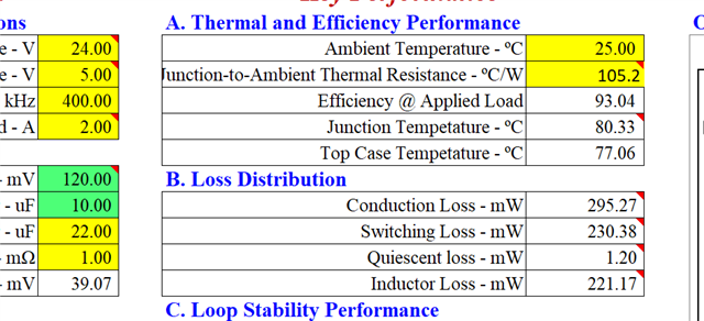

How can I estimate the MOSFET and IC losses to determine the junction temperature when the datasheet does not provide nominal dead-time, rise/fall times, or parasitic capacitance?
Hello Ankita
I would recommend using QuickStart calculator of this device for this purpose
you can find it on our product page.
