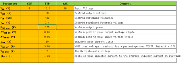

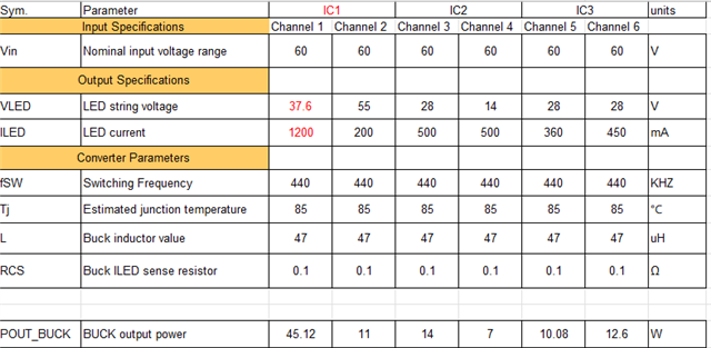

I have a Headlight  quote project which we want to use 1*TPS92682 with 2 phase CV boost and 3* TPS92520 CC buck .
Related requirements as below shown:
For TPS92682 2* phase CV boost:
For TPS92520 CC buck:
Input voltage: 60V
Output voltage range: 2-55V
Output current rang: 0.1-1.5A
1 channel need to support Max.45W 37.6V/1200mA
other 5 channel need to support Max. 30W。
totally allowed output power Max. 100W
I list the possible power dissipation distribution for your reference,
my question:

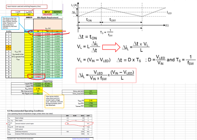

1)  CV boost output 60V, CC up to 55V, is it OK or not?
2)  CC  chip IC1 one channel 45W, tot 56W, is it OK or not?
3)  Do you have power dissipation calculation sheet without PROT contain TPS92682 and TPS92520 can share to me?
4) Is it possible to use TIDA-050030 120W Dual-Stage Matrix Compatible Automotive Headlight ECU Reference Design for quickly quote EBOM?
5) Do you have detail 2 phase CV boost step by step application calculation method for external E-parts share to me ?
6) which is max. allowed power dissipation for TPS92682 2phase CV and TPS92520?
other unclear information, let me know.

    1.  I can't answer this without knowing the desired switching frequency.  Do you have a specific desired switching frequency?  There is a min off time which sets that max duty cycle.  55V/60V = 91.67% duty cycle.  That should be ok at lower switching frequencies like 440 kHz.  You also have to make sure you meet min sensed ripple spec of 20mV, which is dependant on peak to peak ripple current in the inductor and the current sense resistor used.  ripple current is dependant on lots of variables too.  current sense resistor selected is based on max current supported.  If you need 1.5A then you would need 0.1 ohms for current sense resistor.    I did a quick calculations based on some assumptions, and it looks like you are marginal at the 59Vin and 55Vled and are marginal at 2Vled for all input voltages.
    2.  The device can handle the output power but it really is a question of heat management.  Can you provide enough heat sinking such that it doesn't exceed the max junction requirements of our device at those high loads and with a hot ambient environment like 105C.  .  You will need to minimize the gap between top side thermal pad of our device and make sure to use low thermal resistance gap filler.

    5.  There is a calculation sheet on the TPS9268-Q1 page.  https://www.ti.com/tool/download/SLUC690 There are several of them and you should go to the main page to look for tools, reference designs, EVMs, User's Guide, Datasheets, etc..
    6.  I can't give you a simple number because it depends on operating conditions, heat sinking, component selection, and lots of other variables etc.  Can you make a two phase boost output 130W, sure, but you have to design it properly.  You need to select components to ensure that you don't expose those parts to temperatures outside its max operating junction and that depends on heat sinking and ambient environment specifications, and operating conditions.  The TPS92682-Q1 is a controller so that shouldn't have that much power loss.  Most of the losses are in the power components such as switching fet, diode, inductors, etc.  The TPS92520 can output a lot of power but again it then becomes a functions of thermal management such that you don't exceed our max operating junction temperature.  We have output 60W in one IC before but again you need good thermal management.
